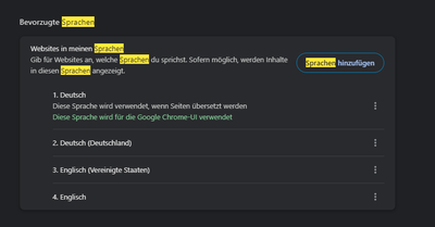

s_taifour
hi @dave_fagerstrom ,
i could only notice this problem in parameters.
here are some screen shots from my browser, its all in German until i click on managing parameters then it switches to englisch.
i also tried to delete all cookies, and incognito mode, that didnt bring anything.
just for info, if i remember correctly, ive created my account at acc.autodesk.com then switched to the European  platform.
thanks, and best regards,
Somar

dave_fagerstrom
Hi Somar,
I'm asking our localization experts if they have any insights here.   We do have german translations, and I can see them on my end.
Can you try temporarily changing your browser to using just Deutsch instead of Deutsch(Deutschland) and see if that makes a difference?   We may need to pair some further specific locale browser languages to our language packs if it's passing a language code we don't recognize.
Let me know if that makes a difference and if it does I have a good idea of what we need to fix.
~Dave

s_taifour
Hallo  Dave,
it did actually work!, after setting just "deutsch" instead of "detusch (Deutschland)" as the first language for chrome, is the translation displayed correctly!
Thanks for the help! @dave_fagerstrom
Best Regards
Somar
