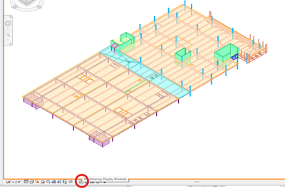

If it is a work shared project, you may have accidentally turned on the workshare display and everything is on one work set which has defaulted to red.
Check the button shown below.

Shamseera.kk73D7Q
its off
