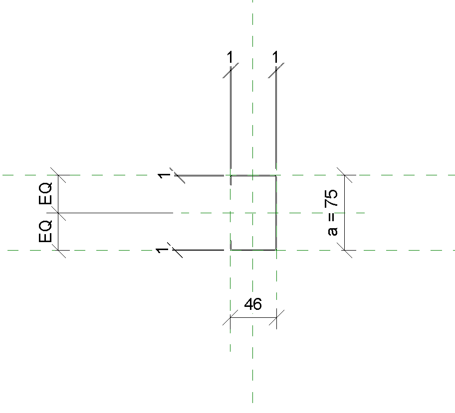

Hello, I have a curtain wall profile, which I would like to snap to the center of when dimensioning. I have a ''strong reference'' in the center of the profile, but even with that, it is only snapping to the outline of the profile shape and the reference that defines origin. I know I could make the center reference origin defining, but that is not preferable in this use case and the dimensioning is not working on the last member within a curtain wall anyway.
Am I missing something, in order to solve this? The profile family is uploaded.

You need to position the Profile around the Centre Axis of the Mullion Family (Centre of Mullion)
because if you think about it you are dimensioning the Curtain Gridline not the Mullion!
Alternatively you could use TAB Key select to try and Cycle select the Mullion reference planes!

Hi Jay, that is what I wrote about making the center reference origin defining (same principle as you suggest). It helps partially with dimensioning, but not completely, it still struggles at each end of the curtain wall. Aditionally, as mentioned, I still need the center grid line as is for the purpose of designing for our production. The TAB key does not work at all for any reference planes.
