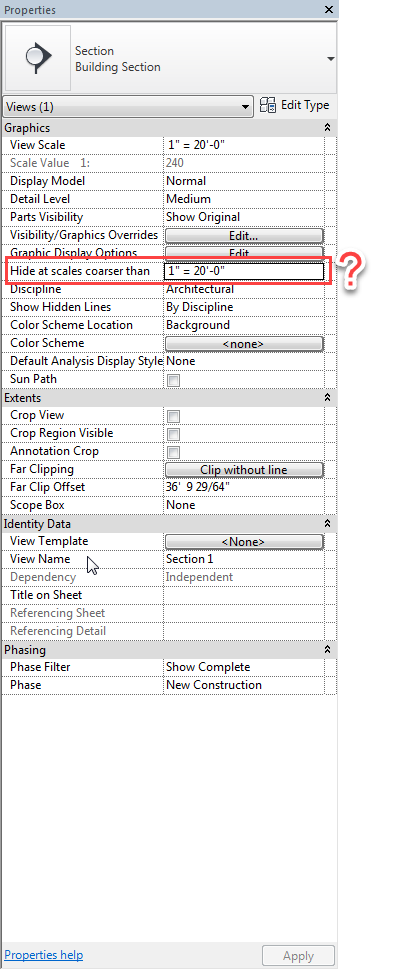

Hello, I have created a map and copied this. Then I created a drawing and created the map in 1: 500 in a window. I make a cut in the layout plan and the cut is made only the cut is not displayed in my plan in the drawing. But it is visible in the original map.
How can this be done? I checked the visibility settings.
When creating the cuts in the plan, I receive the following error message:
"None of the elements created are in plan: Site Map Visible, you should review the active view, its paramenter and visibility settings, as well as the plan areas and their settings."
The discontinued discipline is architecture, but I've already tried all the others.

VG > Annotations tab > Sections = ON

It sounds like copied element is attached out of the view range that you are currently in.

hello, pick your section line symbol in your layout plan and check assign phasing and see if helps. thanks
Nachricht 6 von 7
als Antwort auf: barthbradley
I had this problem. This solved it for me. The section was hidden by scale.
Thank you!
