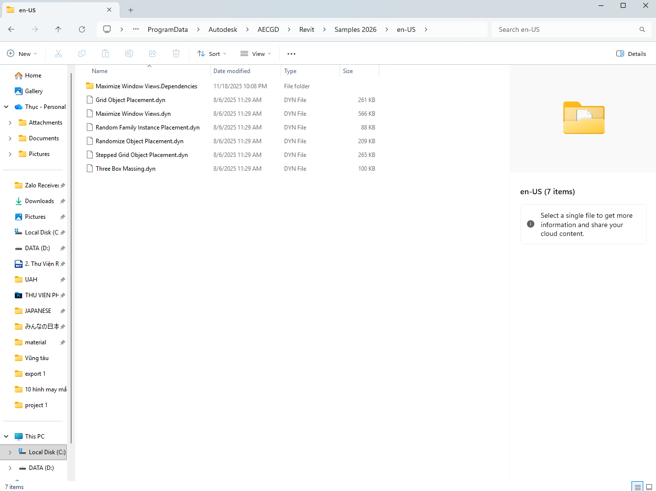

I am using Revit 2026. I wanted to try out "Workspace layout" generative design but i couldn't find the sample file anywhere, and according to videos and tutorials online, "Workspace layout" seems to be among the default sample files by Autodesk.
I couldn't find it in the intitial "Create study" tab, or locate any "Workspace layout" dyn files in the file location where the others are stored. When I tried to manually download online from Autodesk official website, the page is "not found".
Is there a fix or another way to acquire the "Workspace layout" sample file to use for generative design?

Hi @lehaxathuc11 ,
The file you're looking for is attached.
I hope this helped you.

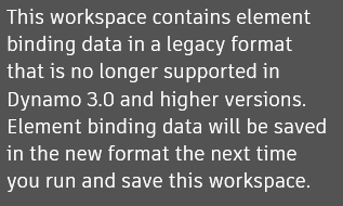

Workspace layout.dyn doesn't work in Revit 2026 GD. I added it to the sample folder, I added it in a separate folder Revit 2026 GD doesn't see it. Is it the correct Dynamo version?
kal_houhouBIM01
I got this message trying to open the graph in Dynamo 3.x:
