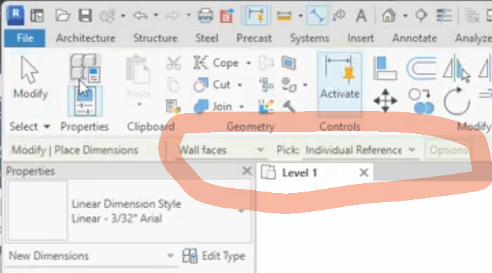

I'm pretty new to Revit (using 2026.2) so have been using both a CADCIM Tech book (Exploring AutoDesk Revit 2026 for Architecture) and YouTube videos when I run into problems. This problem with dimensions has me stumped after about 3 hours reading in the book and lots of googling.
All I want to do add permanent dimensions to a 1st floor plan I've drawn. Seems like this should be pretty simple like it is in AutoCAD. I found a nice video about this that has more or less the same description of the process as the CADCIM book.
Here is a screen cap of what the YouTube video shows after clicking on Annotate:Aligned Dimensions. Note that the here the Revit version is 2025.2. I have circled the Options Bar that includes the snap point for the cursor and here Wall faces is chosen from the pulldown menu.
When I click on Annotate:Aligned Dimensions, below is a screen cap of what I see. I circled the same area in my screen cap below. There is no Options Bar. The dimensions when I add them to my drawing are defaulted to centerlines and I need Wall faces. Blue dot dragging doesn't work because of the default to centerlines. I tried Linear rather than Aligned dimensions and still no Options Bar.
Is there a setting or a property somewhere that I need to set to get the Options Bar to appear or is there another way of setting the snap to wall faces?

It's on the Ribbon, when you click Dimension:
The Option Bar is a remnant of the pre-Ribbon interface (Revit 2009) and apparently it's incredible complicated to move all the stuff displayed on the Options Bar to the Ribbon in one go. Duh.... So it's done one at a time with each new Revit version.
