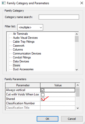

mhiserZFHXS
I'm not sure about exporting to NWC, but for nested families to show within a Revit project file, they need to be shared families within the main family model. Go into the nested family, open the Family Categories and Parameters menu, check Shared, and reload it into the family, and reload the family into the project.
