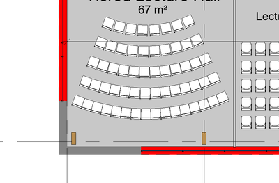

anyone, can you please help me. In the image below the external wall with the red windows is a linked model that has been shared and consumed on ACC, as part of a collaborative project.
The question is, why are the window revels and cills red?? There are no overrides or anything like that in the view settings, so I am at a loss.
Any help would be greatly appreciated.

Looks like a demolition phase graphic override. The default demo settings are red (and dashed) for demo. Is the links phase mapping set up to match your model's phases and what is the phase filter setting for the view?

You were absolutely correct. It was the view phase filters, set to show all instead of new construction!
