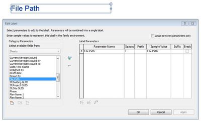

i have my title block of the company. In AutoCad i have the possibility to insert the parameter of the "name of the file", so i can read the name of the file on the Drawings.
It's possible to have on Revit in the family of title block?

It's possible to do this in Revit.
Place a label on the titleblock with the "File Path" parameter. This will read the filepath + file name.

Thanks, i have read so much time the entire parameter but i had not seen Smiley Very Happy
