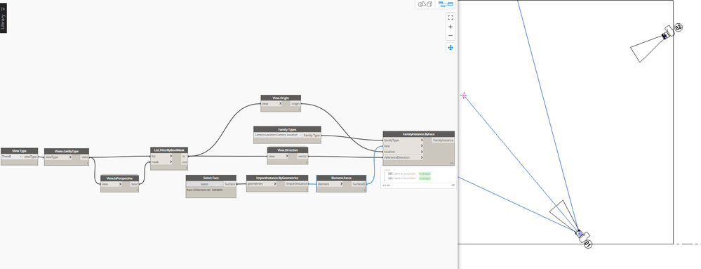

Is there a way to select and/or show all camera locations in a plan view?
Hoping to make a key plan as well as view and delete unwanted cameras.
Thanks in advance for any input!  Revit 2019

You're right; not wrong.  Smiley Wink

What I have done in the past is making use of Dynamo.
I was in a similar situation were I needed a "map" of the camera locations to indicate the location of the different renders. With dynamo I extracted the location of the camera and placed a family on that place pointing in the (approximate) camera direction

@Anonymous, I have looked for the script I have used. I needed it quick so it is not the most elegant one.
What it does is:
It looks for perspective views inside the project (the camera views)
Then it finds the origin and direction of that view (i.e. camera)
Then it places a family instance at that point and with that direction
As the family is workplane placed I first have to select a face (a floor in this instance) to host the camera family .
Hopefully a starting point for your dynamo endeavors.
