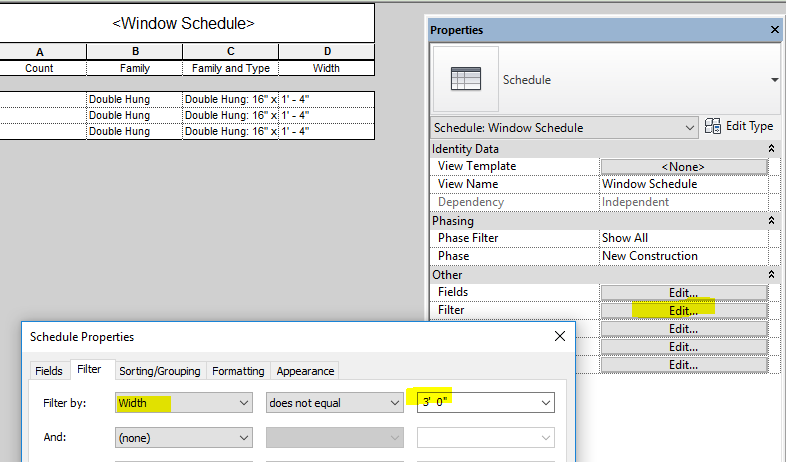

A tip - before you nest the three 'child' windows into the 'parent' window, make sure to delete the opening from the parent! Start with the Window with Trim template. Nest the 'child' windows. Constrain to reference planes. You should be good!
For the schedule - filter out the parent family by a parameter - I filtered it out by width and all I see in the schedule are the 'child' families.
Smart thinking! I just wanted to point out that - without some thought into dealing with it - the three-into-one solution is going to result in four.
