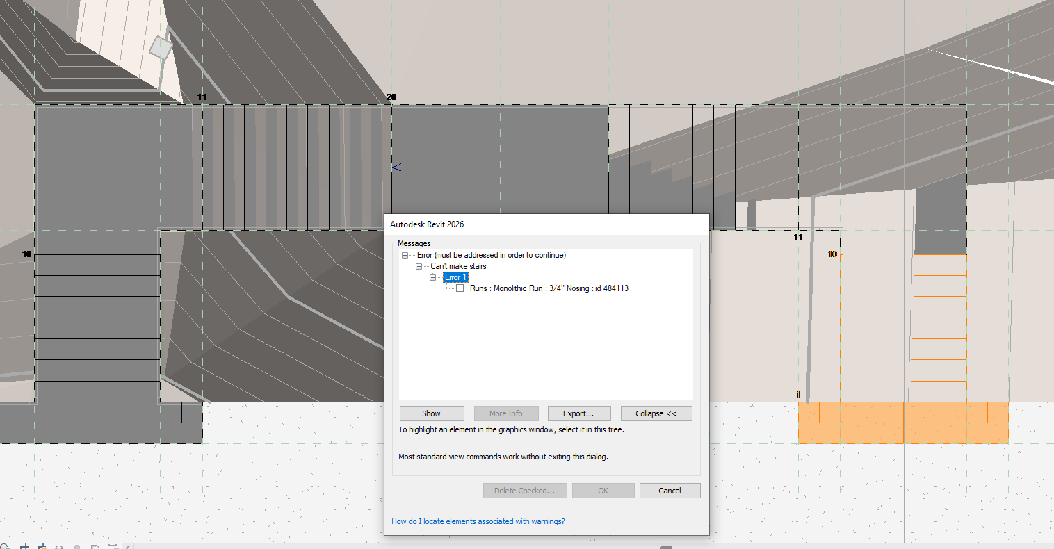

lucey.alan
Thank you very much for the advice on creating a single stair. It all seems to work except for editing the copy of the lower run. I get the following error upon trying to complete the sketch.
