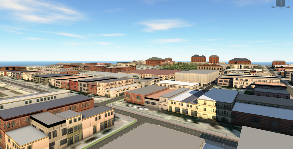

If you don't need an "exact" match of the streetscape you could consider generating context with Infraworks.  In this image the building facades are proceedurally generated. The building footprint and heights are more or less correct but the facade appearance is not exactly what is there. Revit models can be imported and placed into this model for you work.
This context model took me literally about 2 minutes to generate.

Unfortunately we do need a relatively accurate representation of the existing street but this will definitely be useful for other projects. Thanks!

Yeah I thought that might be the case. Infraworks does allow some control over a facade but I would be kidding myself if I thought it could faithfully re-create an exact streetscape.
For quick context models though, it can't really be beat in ease of creating a model.
