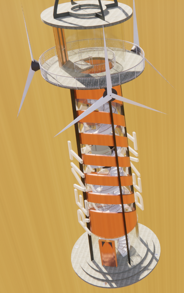

Good morning, I have this model with a 3D Text (I wrote down "REVIT" as a sample text), I made this a few years ago. I have been trying to place the same text on the 4 sides of the model by copying, arraying, rotating... nothing works.
Any suggestion please?
Thank you

Sounds like the Model Text is improperly hosted. Can you post the file for us to inspect?

Did you tried with copy(CO) comment instead Ctl+C
can you compress another way? I don't have WinZip. If you compress with Windows, you should be able to post it as an attachment.

Perhaps try grouping and then copy (CO), not sure why it won't copy though...
syman2000
I've look at the model. The original model text lost it's associate host. Even if you want to mirror, it just fly off the model. So your easiest way is picked the surface of the frame and add text.

As per my insection need to just rehost.
