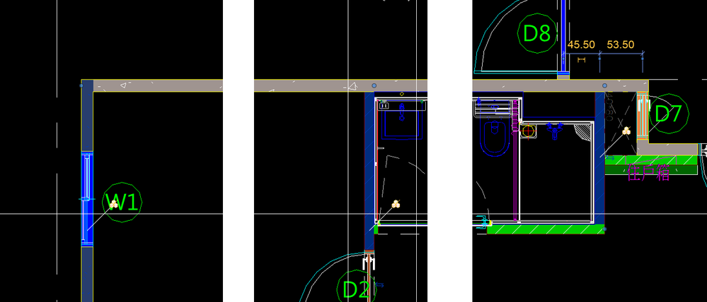

Has anyone encountered this issue before? Some walls don't show temporary dimensions when selected. I've already tried restarting Revit and using the copy-in-place → delete → paste method.
I can't reproduce the problem in a small project, since the elements work fine after being copied there.

Have you read this article Temporary dimension not displayed in Revit
  • Sometimes I have seen this and it turned out a link in the model when unloaded, temp dim work again
  • Some other times I have seen this it is the project (local file) file itself. Deleting it and recreating new fixed
  • and I have also seen it on a nonworkshared project where restoring a previous save fixed the issue
Sleepingfish_Kuo
Thanks, the Activate Dimensions button works.
