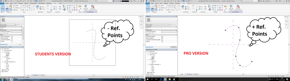

Hi Revit Architecture Forum
I just installed the Revit 2018.2 - STUDENT VERSION
and I can't see any Reference Points in my splines.
I worked with splines in the conceptual mass family file.
Anyone knows or seen this problem?
This happends only on the student version. Not in standard version...

Just a guess here, could it be one was drawn using the "spline" tool and the other was drawn using the "spline through points" tool?
These 2 tools will give results like you are showing.  I think casting the blame to the "student version" is a red herring. I can assure you they are the same "software wise". We are doing nothing special like this to cause a difference like this in the student version.

If it is not the kind of spline drawn, maybe it is the VG of the view.  Reference points category turned off?

Yes my Reference Points are checked in visibility graphics

Sorry nothing helped by changing into default background colours....As I tried to explain the missing points are only on my STUDENT VERSION Revit 2018 program runned on a windows 7 DELL pc and not on the PRO VERSION at all. Explaining why others don't have this problem on their Installations.

My conclusion on this is that it could be my pc video card or other hardware issues that is not dealing with creating points on polylines.

GOT IT!
After running a service check for graphic drivers. The points are now showing.
YEAH...
