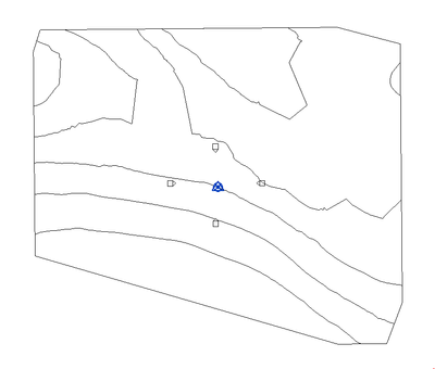

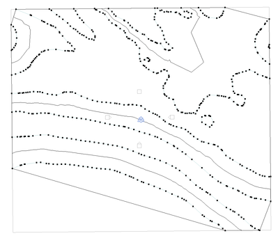

I'm trying to sort out why only some of the contour lines from my .dwg get put into a topography model when I use massing and site.  See images below to understand what I mean, each has a caption to better explain.
Complete Contour Lines from .dwgComplete Contour Lines from .dwgSelection in Revit Massing+Site<Toposurface<Create From ImportSelection in Revit Massing+Site<Toposurface<Create From ImportAfter import; Black Lines represent what Revit grabbed, brown lines are original .dwg fileAfter import; Black Lines represent what Revit grabbed, brown lines are original .dwg fileWhat I'm left with at the end.What I'm left with at the end.

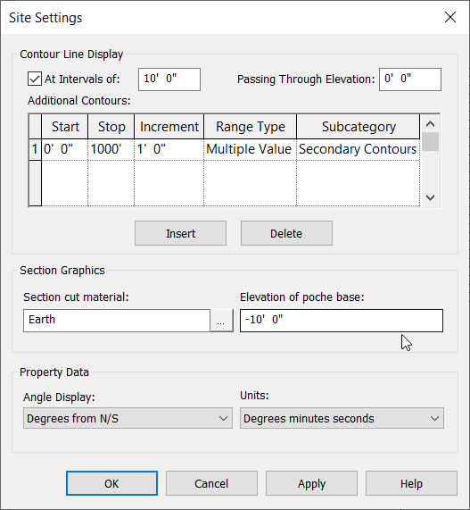

site settings
Nachricht 3 von 17
als Antwort auf: barthbradley
And change what? The elevation of the poche base?
Nachricht 4 von 17
als Antwort auf: Anonymous
this is where you define your contour lines/ intervals.  This is what you're talking about, isn't it?

What I'm not understanding is why when I create a toposurface from an imported .dwg file it does't seem to transfer the contour lines appropriately.
The first image is Revit grabbing all contour lines from my .dwg and creating points on them but then what I actually get after clicking 'done' is very different (image 2).

Looks the same as mine.
Cause your actual 3D form is only showing the black contour lines, correct?

What are you taking about? I mentioned nothing about Sketchup or about "creating" anything.  Read again.  And after you create the Toposuface, it's all about Contour Lines and Interval setting as I originally told you.  You can get the contours to line up exactly like is shown in your dwg -- if you really want.  I wouldn't bother myself. They are not standard intervals.

Oh, are you saying you don't have AutoCAD? If so, forget that part.  It's all about placing the Toposurface at the correct Elevation in Revit and changing the Contour Lines/Intervals under Site Settings.
