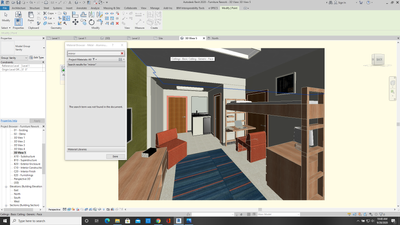

I'm trying to find a standard mirror material for a frameless bathroom vanity mirror. All the searches I've done online seem to assume that it can be found in the Revit material library but I can't find it in mine anywhere. I'm using 2020  and I'm a relative newbie so thanks so much for helping me out 🙂

Use the search function and you should several mirror material.
That's what I gathered most people were doing but here's what happens when I search for "mirror" ???
syman2000
Hmm...did you check and see if can add the library.
https://knowledge.autodesk.com/support/revit-products/troubleshooting/caas/sfdcarticles/sfdcarticles...
There are numerous Appearance Assets in the OOTB Asset Browser that you can add to a New or Existing Material.
