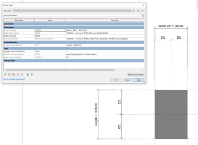

I am student working on a custom skylight family where the Width can be specified by the user and the Length relates to the given value by 1.5 (Length = Width * 1.5), with no max Width. However, a requirement of the skylight is the minimum possible area is 1.0 sqm.
How do I write an IF formula where the user-given Width relates to the minimum required Area?
I tried a formula but it apparently "cycles":
Width - IF (SkylightArea < SkylightAreaMin, 816 mm, Width)
I hope someone recognizes my intention. If not, I can answer any other questions to clarify the situation.

use an additional parameter ..W in my example...

“Length” should actually be the evaluated parameter. Replace “=Width*1.5” with this formula:
= if((1.5 * Width) > Skylight Area Min / Width, Width * 1.5, Skylight Area Min / Width)

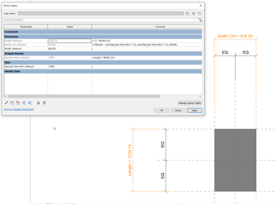

Hi @barthbradley,
I tried to input the formula but it doesn't work as I want it to.
The premise is to have a minimum area of 1.00 sqm, maintaining x as the shorter side, and 1.5x as the longer.
Thanks for the suggestion, I tried it. Unfortunately, it's missing the function where it changes Width to an appropriate number where it maintains a relationship with Length with a factor of 1.5. Example, I entered 600 mm as Width, and the formula gave me 1 666.67 mm as Length. Which is not 600 mm * 1.5.
With lots of tweaking, I think I'll stick to what I have come up with. It may look messy but I think this is the most stable I got. Notice how it overrides the manually entered value of 600 mm:
-MC

I guess that's how my new formula involved two more parameters (SkylightWidth, SkylightLength) which are attached to the model's dimension.
"WidthEntered" and "LengthEntered" would be the user-defined parameters.
It doesn't cycle since the user-defined data is merely input (i.e. WidthEntered), and the processing and output are a different parameter (i.e. SkylightWidth).
Also, another requirement is to maintain a 1:1.5 proportion between the two dimensions. That's why 600:1666.67 doesn't work.

Nachricht 11 von 11
als Antwort auf: Anonymous
Not only a Skylight Area Minimum, but a Width Minimum based on an Aspect Ratio as well (e.g. 1.5:1).   Note: "README" and "Minimum Width" and "Aspect Ratio" are not necessary parameters if simplicity is the aim.
