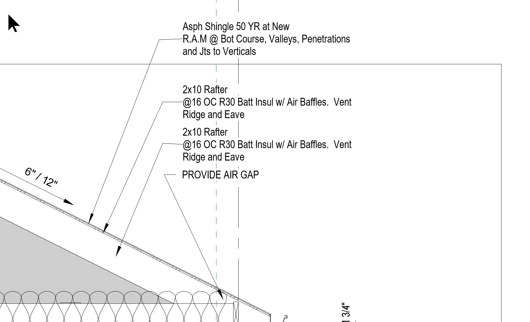

Roof material layer wont display.   Its the same material in a different section:   In both views:  Exact same view template, exact same material in (view where it wont display picture in) jpg # 1&2 where the material wont display (fine detail display ... both)   as jpg #3 (where it does display)  The view template has everything checked - all variables are the same in both.    It isn't hidden, via display override.  What else can it be, to make this roof material layer display ???

Common Edges unchecked in VGO?  Override Host Layers Cut Line Style checked in VGO?

Can you change its function to something other than thermal/air layer? There might be some oddity associated with that. I have no specific reason to think this, but am wondering if one of the views is a detail callout/section and the other is a "regular" section. Either way, changing the function would be the first thing I would propose.

Yes, I I've tried all 6 "Function" assignments.   no help.
