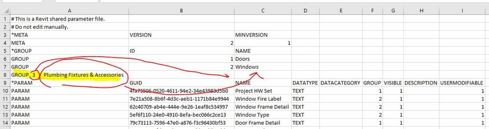

I know that this has been asked multiple times - but maybe someone has come up with something new? I have inherited multiple Shared Parameter TXT files - how can I bring them together  into one?

I have inherited a bunch of them - one for Walls, one for Doors, one for Windows - you get the gist? It would be easier to have all of them in one file with the parameters in groups. I did try the copy and paste method - did not work!

You could try to open the files in Excel and copy paste rows from one file to another. Make sure the GUID value is unique for each and every row.  Pay attention to the value of the Group column as well and make sure you regroup them properly.  Do it on a copy just in case.

Not working. I copied info into Excel, exported it out to TXT, and Revit does not like it.

You cannot just copy paste save and call it a day.  You need to look carefully at the GUID, the Name and make sure they are all unique.  if not then you need to rename them.  I did a simple test and Revit can open and use the merged txt file just fine.  With that said, it is not worth pursuing.

I did look carefully at the GUIDs, names, groups, etc. When I save it out as a TXT (delimited) and attempt to look at it in Revit, it gives me an error. What could I be missing?

Can you share the merged file her?
Message 17 of 36
Sahay_R
@ToanDN  - here you are. Thank you in advance! Group 3 is out of the merged file. And there are a lot more files that should be merged into this.....

Try this.
Open both files, this one and yours, in Excel you will see the obvious problem.
Message 19 of 36
Sahay_R
@ToanDN  - Was this the only one? Your file does work nicely in Revit.....

And how did you take it out of Excel to TXT? When I take your file out of Excel to TXT, it goes kablooie again.....
