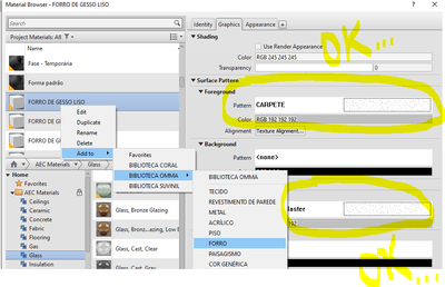

Hi, i have a problem:
i created a material with patterns for the surface and cut. After, I add this material in my library. Look:
Now, the problem: Why my surface pattern desappeared when I visit my library materials in the new project or in another file? Look:
I don't understood yet.. thanks!

Materials can be named the same, but be completely different between Projects.  Use Transfer Project Standards to transfer Materials from one Project to another.

I tested this, but dont work.. look:
All material I add in custom library dont have patterns when I created for then...

Dont work... the problem is the library materials that don't keep the patterns...

Maybe I got it wrong, I think the custom material library should keep the hatches. They already exist in the template file too..

I created new materials and add to library (with patterns). When I open a new file, the materials are there but still without the patterns... so, one question:
Should a library keep the patterns? Is it possible? Am I wrong about this?

The fill patterns added to the materials exist in the project where you created the materials, but they may not exist, or may have a different definition in the project where you import the materials in.  The sure way is transfer project standards (materials and fill patterns) from the source project (where you see the materials display correctly) to your projects.

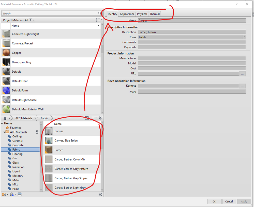

In case you want to understand why it is happening, Autodesk material libraries are shared among several Autodesk software, not just Revit.  The graphic tab of a material is a feature of Revit, but may not exist in other programs, so the tab  does not show when you look at a material in the library, and only shows when you import it in Revit.
