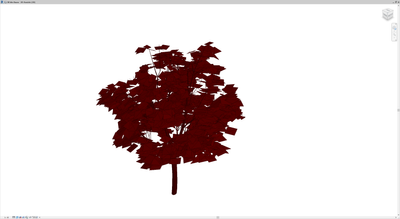

Hi, I worked on a tree in 3ds max, exported as DWG, imported into a vegetation family, got it in this brown colour.
I have no idea where can I change this... or apply a new material to it?
Thanks!

You can not change the material in a DWG imported file. The color is the same as the layer in the CAD file

Override Graphics in View By Element.
....and/or go to Object Styles =>Imported Categories and assign/change "Material" for Import.
