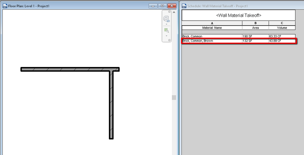

This question is about precision for creating Material Take-Offs in Revit.
Many joins are being "cleaned up" by Revit. Whenever we use the "Join Geometry" tool, its almost as if we tell it to cut some pieces of geometry or extend other. When we look at the "cleaned up corner"  between two walls, the extent of the wall location line is not always the same compared to the extent of the actual wall which was joined with another.
This is my question:
How Revit computes material volumes and areas after we have applied the Join Geometry tool and all wrapping materials, slopes etc? I assume that it is not as simple as just using Location Lines, thicknesses and Heights. I would like to have at least some understanding of this to be sure that it is doing it with a desired precision.

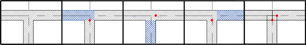

In the simplest terms, the material in the "overlapping" joined geometries will be "discounted" from the material takeoff. But it can be complicated to figure out exactly what is being discounted perhaps.
For example in a "T" connection on  2 walls the wall that is getting "shortened" as it is connecting into the other one at the "T" joint is the one that is reduced, the volume of the crossing wall is not affected. On a simple "T" connection this might be easy to explain or deduce what is happening. In a more complicated joint, it is perhaps not so easy. I can't say I have a summary of the exact coded behavior or logic used. I would say generally if the cleanup/join is altering the geometry as it relates to the position line of the element then that material is getting discounted form  the material takeoff.
Generally I would also say in most cases this is going to fall well within the margin or error for a construction material takeoff.

You are correct. Take these 2 examples below. In one, the wall intersecting the "T" is reduced, in the other the wall is exactly the same length, but not touching the other wall to form a "T" join, so the area/volume is slightly larger.
In a simple connection like that it is easy to understand the behavior/logic applied. In a more complex joint this might not be so easy to see, but the general logic is followed. Thicker walls, miter joints, etc... are going to affect this slightly as well, but again I think the material takeoff is going to be sufficiently accurate to order building materials for a project.
