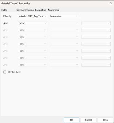

I have a material takeoff shcedule on elevation sheet. There's a first empty row I don't know how to get rid of it.
Anyone has any idea?
Conditions below:
 - Tag/Type is a instance parameter based on shared parameter.
 - Filter: Tag/Type - has a value
Thank you folks have a wonderful holiday!

Set the filter operator to "is greater than" and leave the text field blank. This will filter out any materials that do not have a value assigned for this parameter. This will then get rid of that blank first line. This is how we have our finish schedules filtered as well.
RDAOU
@taejooY875Z
You have the option "Itemize every Instance" unchecked, which implies the schedule is capturing some categories/elements, which has some values but are combined into one blank row (under formatting set to blank) …
You can start by, removing sorting and checking the box Itemize every Instance to figure out which categories are causing this blank row and empty their values
taejooY875Z
Yeah I think this works great. Thank you!
taejooY875Z
Yeah I played with that option. It works for some other schedule but didn't give me what I want for this schedule. I think the post above using filter "greater than" works for this case.
