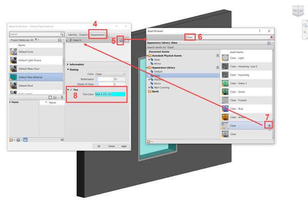

You need to associate a material parameter and/or a subcategory to control the material of the glass geometry in the project. If you need transparency in elevation, check elevation transparency for the opening cut.
associate material parameterassociate material parameter
elevation transparencyelevation transparency

As I said, there was no parameter to check the materials, there was no subcategory attached, I put a parameter to control the type of material, the glass and the frame, and I changed the configuration of the glass material as I and @barthbradley said before.
