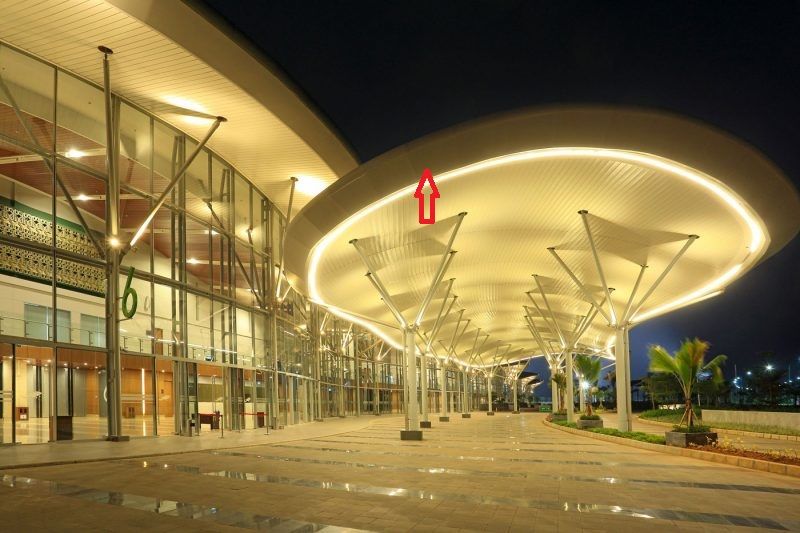

How if i want to make the cover a little bit curve  like this picture ?

How can i add led strip in revit like that picture ?
Because after that i make the animation with Lumion
Thank You
