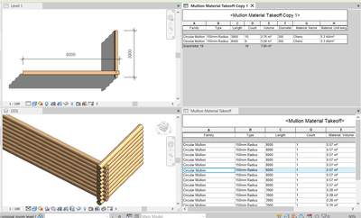

julioRCRE2
als Antwort auf: ToanDN
Hi again, after 2 years I'm following up on this topic and also I want to say thank you for all the valuable information provided, it is been super good and helpful.
I'm revisiting the matter because I want to implement this as my initial log panel source, right now we do all the panel extraction in Autocad, basically manually.
I created a little revit model where I'm able to extract all the mullions information and create a schedule. I'm able to also break the mullions with a wall opening and the pieces are reflected in the schedule.
I want to be able to label every log(mullion) with its information(as showing in the panel sample). It is possible to do that automatically or with tags?
I don't know if I'm going in the right direction here? some input would be great.
Thanks again.
