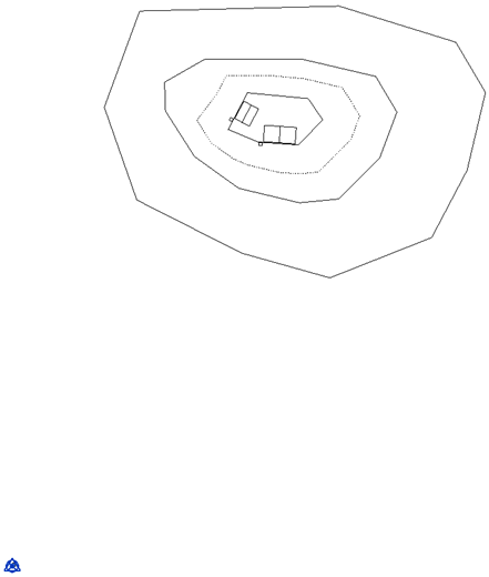

Model.rvt – In this file the PBP and model origin are also in the same location at startup usually some distance off from the intersection of grids.image.png
When I want to start using the site coordinate system I just link the Model.rvt to the site model and then move and turn the link to the correct location.image.png
Small squares represents the models origin (Linked two buildings)
When the move and rotate actions are made then I just click the link and from properties “Shared Site”
I Record the current position to the Model.rvt and click OK. When saving the project it asks:
After saving the coordinates are saved into the Model.rvt
In the Model.rvt the PBP is still in the same location but the SP has moved and the angle to true north has changed.
