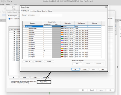

camilaF5NLC
Community Visitor
Community Visitor
I've been facing the same issue in line styles and here's the solution:
Instead of editing through MANAGE>LINE STYLES, inside a 2d family you have to go to VIEW> VISIBILITY/GRAPHICS> OBJECT STYLES
