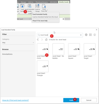

Have you checked the Level type? Is there a Symbol attached?

I've clicked onto that and it just says 'none' and has no other options to select something
ralphdenhaan
You can download the default one from the Autodesk Family Cloud or transfer it from another project template.
And then add it to the Type.
