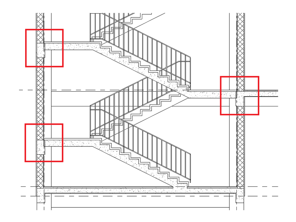

Is there a way to join a cast-in-place staircase and its landings with surrounding civil elements - like columns, beams, slabs etc?

Stair elements do join with floors but even if both have the same material, you wont be able to get rid of that line at the joint except in 2 cases:
  • if you use invisible lines (switch join order of the beam and floor first)
  • if you convert the stairs to a generic model (which eventually will happen if one needs to add/host reinforcement)
