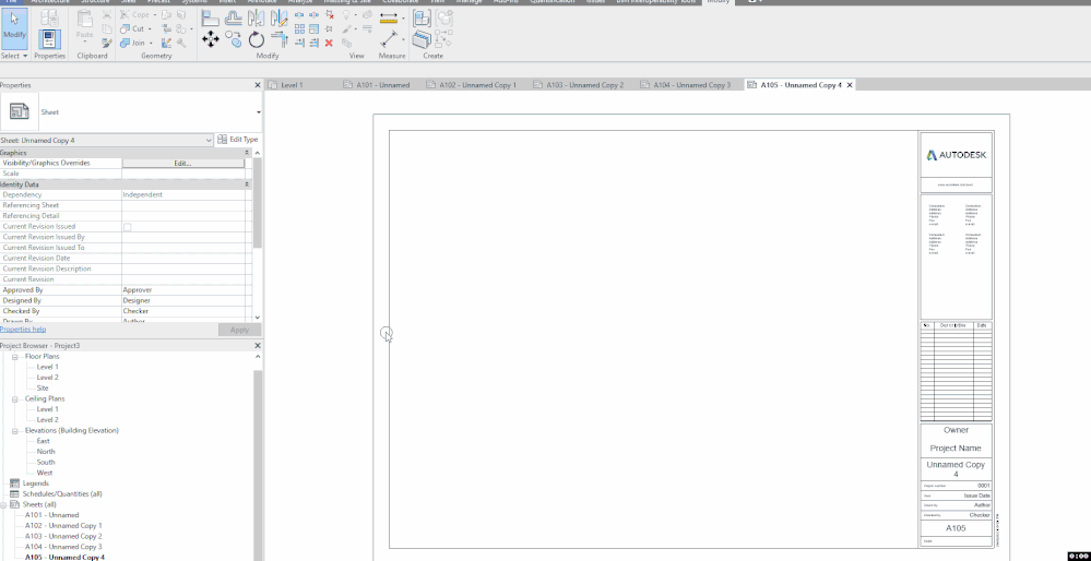

You cannot do what you have in mind since Parameters for Sheet Categories are only available as Instance parameters. Meaning they will not automatically populate the same value for all sheets. If you have to change them for all sheet instances then the easiest would be either of the following:
  1. Either by selecting multiple sheets in the browser and imputing the values in the Properties palette
  2. Or by using the sheet list as follows
    • Create a Sheet List
    • Under Sorting and Grouping >> un-tick Itemize Every instance
    • input the values/dates
    • Go back to S&G and tick the itemize every instance
Message 16 of 18
abehnke56KWR
This ended up working, I shall see if my team is okay with this solution. Adds an extra step to what they've done in the past. Past titleblocks we were able to enter in dates and have them populate without having a sheet list, perhaps the past parameters on the old titleblocks were not Instance parameters? If the shared parameters that i have now in the new titleblock were type parameters, would what i have in mind work?
Message 17 of 18
If the Shared Parameter/Project Parameter is assigned to Project Information ONLY, then the value inputted into that Project Parameter Field under Project Information will populate EVERY Titleblock Label that uses the EXACT SAME Shared Parameter. In other words, the Project Information Project Parameter works as a TYPE Parameter.
....or you can just go back to what I suggested in Message #4 - Family Type Parameters to drive Labels in the Titleblock Family itself.
