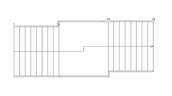

I tried to create a straight run stairs either by component or component, neither of them seemed to be convenient to me.
By component, the second run always shifted even though I tried to align it with the first run, don't know why? It seems to me that it is easier to edit the stairs created by component, but there is always this shifting which is annoying.
By sketch, it was difficult to control the landing depth. If I edited the temporary dimension, the landing would overlap with the treads. Then I tried to move the whole second run treads using the new landing line as reference, it gave warning "Highlighted lines overlap. Lines may not form closed loops". It seemed there was no way to edit it.

Just edit the stairs and move the second run to align with the first one.
By the way, there is no shifting unless you picking the second run not aligning with the first one.  I can draw them straight on every time.
Is the box below un-ticked by any chance?
Message 3 of 12
Thanks for the movie, I noticed when I initiated stair by component, on the option bar, the default setting for the location line was Exterior Support: Left, once I changed it to Run: Center, I was able to draw it straight.
As for using the stair by sketch to draw a straight run, I still had no idea how to control the landing depth. After I drew the first run, i could see the blue dash line for me to indicate where to start the second run; I wanted the depth of landing to be 8', but there is no temporary dimension there to help me start the second run at the right distance from the first run;so I went ahead to start the second run with random distance. After I finished the second run, I tried to edit the landing depth, so I clicked the lowest line of the second run to display the temporary dimension of the land depth which is 4'10", after I changed it to 8', this line jumped to overlap with second run treads,  I tried to move the whole second run treads to align with the landing, it gave warning "Highlighted lines overlap. Lines may not form closed loops".

When I used stair by sketch to create the stairs, I got error messages "Stairs require no more than two boundaries (chains of one or more Boundary Lines)."
also, 27 RISERS CREATED, -9 REMAINING, I know the negative remaining number is because I tried to create split staircase, how to deal with this type of stairs?   Please see the attached jpg file. Thanks!
Message 11 of 12
Looks like one of many limitations of Stair by Sketch.  Why don't you try Stair by Components for one?  Miles better than sketch.
