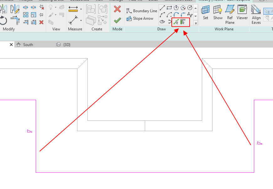

it could be Plate Offset from Base as already mention in the previous post, or:
  • could also be a result of how you've defined the Offset when in Edit Footprint: the result is different if you use : Pick Lines or you use Pick Walls. So check if you have both settings or , if you used Pick Walls they have different eave depth..

@ejowalter wrote:
Is there any way I can prevent the chimney from conflicting?
The chimney is not "conflicting".
Is it an "Offset" Parameter or an "Overhang" Parameter?  Two different behaviors.
I think what you did was use the "Pick Walls" method on only one side. "Overhang" means Pick Walls was used.
