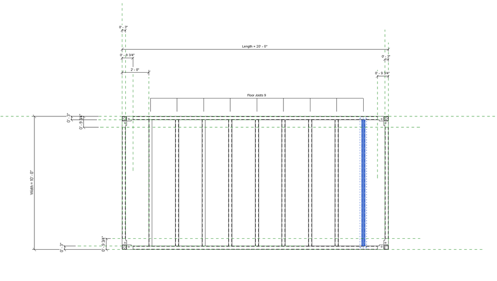

So I'm trying to make an array group's length to be parametric to the overall width of the family.
The ends of the joists are locked to the appropriate reference planes (the ones 3" off from the total width reference planes).
Before doing the array, it works fine when I change the width by both dragging the reference plane or changing the value on the properties window.
But as soon as I make the array and change the width on the properties window, I always get an error with the groups or are forced to remove the constraints. It works fine dragging the reference plane though.
What could be the issue?

Make the Reference Plane a Strong Reference. Try Ungrouping the joists.
Save and Load into Project. See if you can drag with grips.

Thanks for helping out!
I would need the joists to be grouped because the numbers have to change depending on the length of the assembly.
Made the reference planes a strong one but still can't make it to work. 😞
Message 5 of 27
Hi! Thanks for helping out all the time 🙂
Changing the number and spacing of the joists depending on the length of the assembly is no issue for me.
It's when changing the width of the assembly (which is the length of the joists) that I'm having issues with.
It works just fine when I only have 1 joist placed. Changing the width works just fine and there's so errors in having the joist change the length as well.
It's only once I make it into an array group that causes the joists to have issues changing it's length according to the width of the assembly.

I think this may be related to how you are appending the array. I think you want to Append to End. That requires a different Array setup to work correctly. Also, is your railing baluster a nested family?
I would be helpful if you could post the family.

If I recall correctly you need to create to add the second instance, get out of the array command and constrain the second instance properly (both ends in your case), then change the array number to a parameter to finalize the joist system.  If it doesn't work out, share the family.

@Anonymous: Ah! Sorry I misunderstood you initially. I know exactly how to correct. The nested baluster family needs to be given a length parameter and that parameter need to be associated to a length parameter in the host. Then you align and lock only ONE end of the baluster. The parameter drives its length.
Like I said, this would be easier to  show you than tell you. Post your family and I'll show you.

Instead of doing a family with an array of 'joists', do a beam system in the project.
Message 15 of 27
@Anonymous...or model your joist family as a line-based family. I can't make it work with the structural framing family.
...if you do it as a line-based family, you would then align an lock the family's [static] origin to an origin point in the host, and then associate the family's "Length" parameter to a "Length" parameter in the host. The array would then flex properly.

Message 20 of 27
A generic or generic line based should work.  If you want to use a structural framing you are better off with using beam system.
