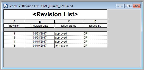

If you want to to use Revit's Revision feature- ie tying Rev clouds back to an entry in a Schedule- you are stuck with it's standard "Revit Schedule" type- see image for Fields.
You could create your own Annotation Family for Revisions and Schedule them this way- you can obviously create whatever Parameters you need then- but it wouldn't be part of the built-in Revision System

Yes it is possible.
Just start with a Sheet List schedule, include the Revision related fields you want, sort by Revision Number, don't itemize every instance, etc.

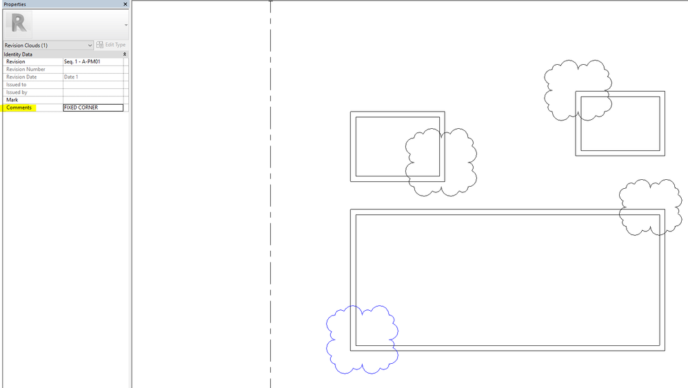

I was a bit unclear, it's the actual revision CLOUDS I would like to add to a schedule. Especially the comments. That way it's easier to write a memo containing all the changes we've made.
Is this somehow possible? To itemize the clouds and their comments in a schedule?

chrisplyler
Ah. No. Not currently possible.
More thorough scheduling capabilities for annotations has been suggested before, but no luck yet.

That's what I though, altough, I recently stumbled upon a plugin that seems to do the job in this case.
https://apps.autodesk.com/RVT/en/Detail/Index?id=2881103757382926713&appLang=en&os=Win64

nmicheels
"Revision" isn't an option within "Sheet List" parameters list.  The only one near that is "Current Revision," which only schedules the NEWEST revision on the sheet and none of the other revisions.
Let me know if i am missing something.
You are not missing anything.
However if you have pyRevit, you can generate a comprehensive Revision report like below:

Install pyRevit and run Generate Revision Report tool.
