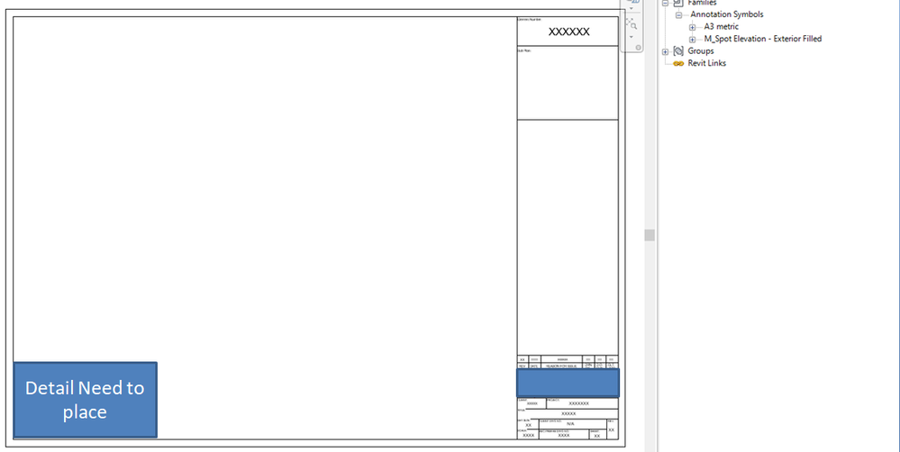

Hii Everyone!!!!!
         how to import Detail Items into Title Block Family or any other options available for my requirements.

Hi @Mohamed_Arshad
You could save the drafting view as an image in the project and then export it and insert into your drawing title block family.
Right-click on the drafting view and select Save to Project as Image.
 Then export the image from Revit as shown in the following image.
Now open the drawing title block family and from the Ribbon Insert (tab) > Import (panel) Import Image.
 Job done.
The only problem you will have is if the detail changes your will need to revise the drawings in the same way each time.

syman2000
If you want your detail to be vector, you can export in CAD and insert into the titleblock. However Revit 2021 allows you to mass copy legend at the right spot. So I would group the detail and then copy it to the legend. Then place the legend on the sheet, copy and paste to multiple sheets.
