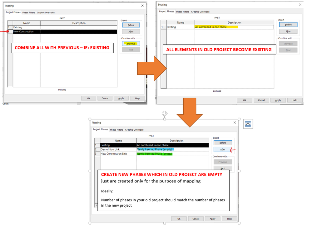

RDAOU
@Anonymous
Step 1:
  1. Open the Linked Model
  2. Go to Manage Phasing
  3. Combine all Phases with Existing (This will shift everything in the old model to Existing)
  4. Create a new Phase call New Construction (this will be basically empty)
    • You do not need the Demolishing Phase but if you insist on it you can create a new one which will also be empty
  5. Save and close
Step 2:
  1. Reload the link in the host model
  2. Map the Phases
    • Existing = Existing
    • Demo = Demo
    • New = New

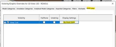

Try out the settings given in message 4
In your host model … set the visibility of the Revit Link to View by Host
Message 9 of 12
