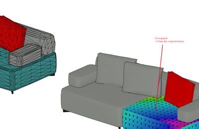

I just want to make sure whether or not there is a way to make smooth surfaces from Sketchup imported to Revit with smooth surfaces and not facetted.
This is what I got - right Revit and left Sketchup
this is the product if you like to try it out yourself.
https://www.bimobject.com/en/fritzhansen/product/alphabet-sofa-series-pl240-1
I got better luck with OBJ, but I am investigating what can be done with SKP

But I am investigating the behavior of SKP imports and looking for ways to control how to present the 3d models.

not much you can do from what i understand with a Sketchup model. i have had some luck bringing a SKP into FormIt and saving it as a AXM and then Linking the AXM into Revit. see the example below....
The top one is the RFA, the bottom one is the SKP opened in FormIt and saved to a AXM.

This is more than "had some luck"
This is a breakthrough :leicht_lächelndes_Gesicht: (and so typically Revit: One has to bend and tweak to reach the goal)
Great work @hmunsell !
Benefits of the method you are suggesting:
* Mesh comes in with smoothed faces
* Mesh comes in UV-mapped!
* Mesh keeps textures (not so critical, but rather convenient)
* When exporting to Twinmotion, each individual sub-element is intact! (unexpected bonus!)
Results in Twinmotion
And finally, this unexpected thing - you can access all the different sub-elements which can be good-to-have.
While the direct SKP-import is just one single object.
