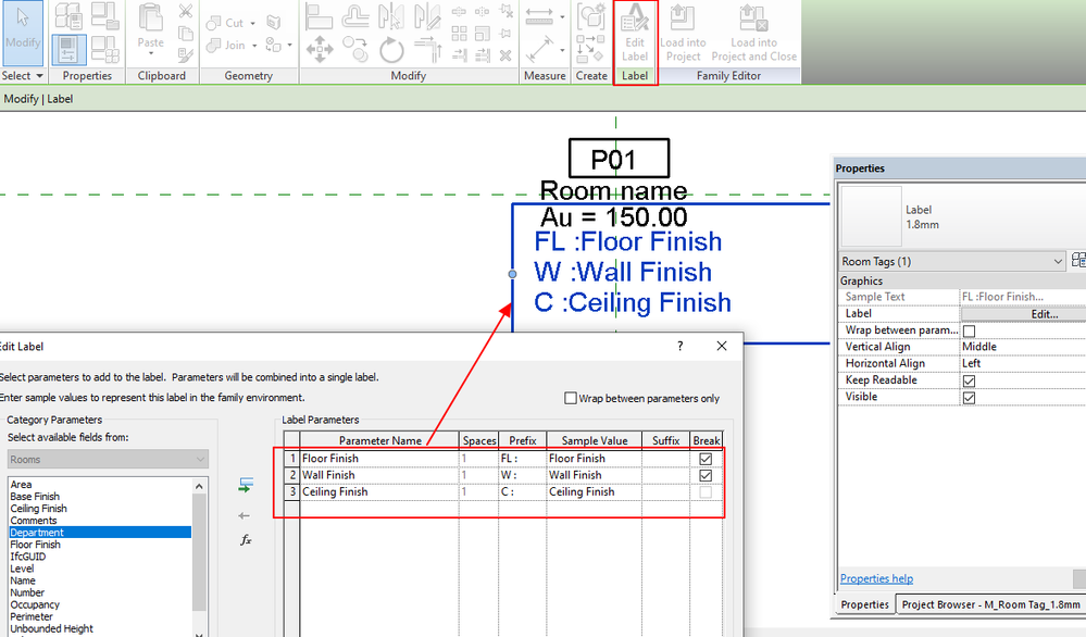

  • Room Tag has to be configured appropriately so to show ( in Plan or Section Views ,where they are visible) the finishes. For this , you have to open Room Tag Family , and create by Duplicate a new type. Create a New Label ( Create>Text>Label) in which to add these parameters:
You can set , also , a Visibility parameter to control (in Project) what amount of information is shown in the Tag:
Once happy with the Tag Family , load it into the Project and it will appear in Plans and Section Views .
