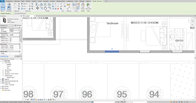

Click this and post a screenshot.
Message 7 of 10
ahmed.xeng

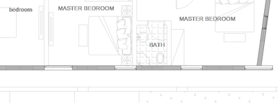

I still have the problem but I found something
Actually the wall it self is moving while aligning and not the window !!
I am not able to select the windows from its edges !! even using TAB key !
Also I tried to adjust window sizes heights and widths and settle levels but nothing changed !
Any help ?
Message 10 of 10
RDAOU
@ahmed.xeng
You are aligning the wall rather than the windows ...
  • Edit the Widow family and set the ref planes (left and right side) properly as reference planes
  • And when you are tabbing through the elements, wait for the bubble tool tip to popup telling you what you have tabbed (it should read the Family name - Reference Plane Name)
