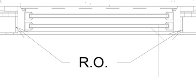

Just by a solid line in the wall, maybe a bit lighter than the rest of the wall core. If the window has a 1/2" rough opening gap then I think ideally the wall family could just display a 3.5" line (2x4 wall) that is offset by 1/2" from the window frame. So if the window moves, the rough opening lines move with it.
Quick sketch of what I mean-

 Then edit the family :
- add symbolic lines to present the rough opening, maybe assign them to a subcategory so that you can turn off when you don't want to see then in the project
- add dimension from finish opening ref plane to rough opening line, associate it with a parameter incase you have different deltas based on wall types
- load it back in project and you can see the rough opening lines

this is foreign territory for me and I appreciate any help- So I am in the family editor, plan view, and made a reference plane 1/4" from the window frame edge reference plane. I dimensioned it and locked it to that frame-edge ref plane. Now in properties>family types, there is a value for rough opening  that is the window width +1". Because my rough opening is only 1/4" on either side I only want this to be Window width +1/2". So I can manually change that value, but it seems like that value should somehow be tied to my new "rough opening" reference plane, no? Is there a way to link the two so I'm not defining it in two different places?

There are several ways. The easiest would be to dimension both of those rough opening reference planes to the center (left/right) reference plane (one dimension, 3 clicks), and set them to EQ. Then, dimension just the two rough opening reference planes, and in the modify|Dimensions tool bar, set the label to your rough opening parameter. You can then change the equation for the rough opening parameter to Window Width + 1/2".
This combination of two reference planes with one in the middle, with the outer dimensions set to equal, and then a parametered dimension between the two outer planes, is one of the most common things you will do in family creation.

I dont want the actual openings of the window to be increased to the rough opening. I want the window size to be correct, but to just have some symbolic lines for the R.O. In CAD we used to make our window plan details into blocks and would just have a lighter line for the rough opening so we could dimension the framing correctly for the builders.

See the revised family for an idea hoe to do it.

Why don't you just include RO Ref Planes in the Family Plan View? Make those RPs the "Right" and "Left", and change the original "Right" and "Left" to "Weak Reference".   That might make you happy.  Give it a try and place a few Windows on one Wall in the Project, press Aligned Dimension, set to Entire Walls and Opening Widths, and then pick the Wall with all the Windows.   Watch the magic happen.
