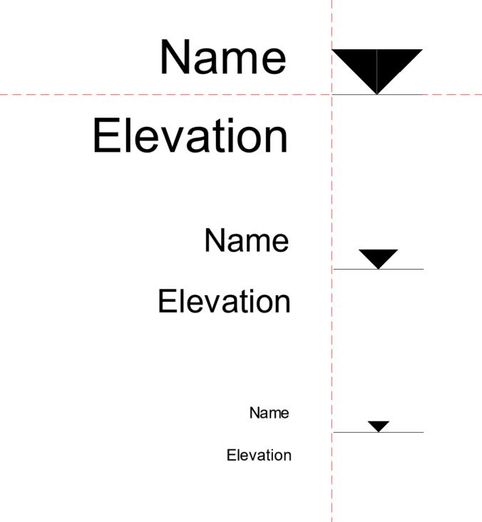

I would like to put the elevation in to A3 sheet, but there are some problem.
1. When i chose view scale 1:500, it is too small for A3. But when i chose view scale to 1:200, it is too large to fit in A3.
2. When i chose 1:500, the level mark was too large

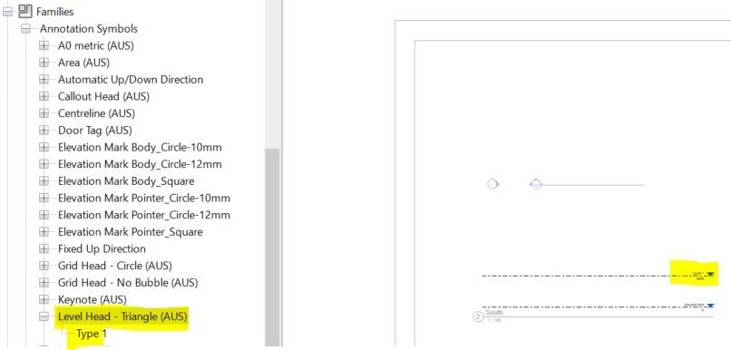

1. In Revit, for any views, the default scales are 1:100, 1:200, 1:500 and so on, and if those scales
are not fitting then you can use "CUSTOM "scale and use 1:150, 1:250 for that matter any scale.
2. The View port tag, levels etc, they are constant size on print scale, no matter whats the VIEW SCALE.
3. You can always custom / create new / edit existing "Level Head" Search for the Level head used for the
Levels, find it in Family, and change the text size and level head size as per your requirement..
Example of Level head triangle.
