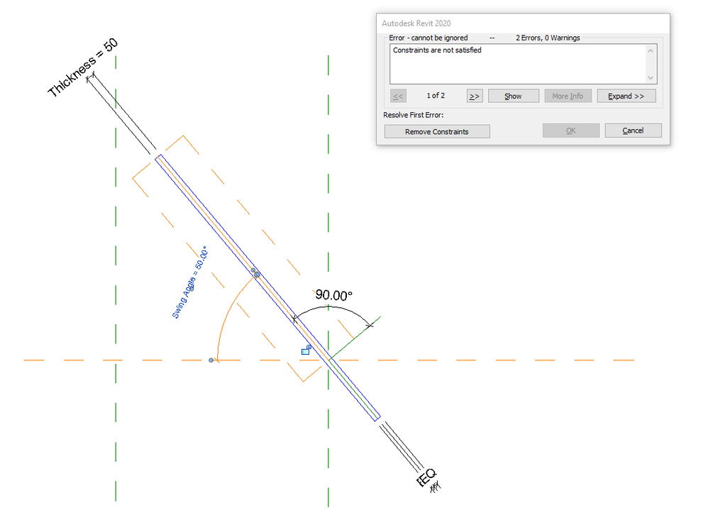

Hi, I'm trying to create a parametric door swing, for a pivot door, is there a way to rotate the drawing from a pivot point instead of the edge of the panel geometry?
This pivot door does not have the rotation point in the edge, cause it has like a kind of and overhang.
I will like to recreate a door swing for plan views specifically, but I don't get to make it rotate from the specific pivot.
I marked in yellow the pivot which I'm trying to make the panel rotate in reference to.
I already tried all but keep getting constrain errors, I deleted all parametric measures. when I change the angle the panel detached from the pivot I want it to be located.
I'm just trying to make a parametric angle to adjust the angle of the door swing in floor plans
As you can see when I change the angle the panel moves from the pivot I want it to be.
Is Revit capable of doing that rotation from a specific pivot where both reference planes intersect at the right side of the image?

Create a reference plane for the door to swing on and set the extrusion to the plane. Dimension the reference plane with your angle, not the door.

Rather use a reference line than a reference plane.

Here you go, you just need to lock the endpoint of the ref line.

Hi, bin thanks a lot. I tried locking both ends points to both reference planes but kept receiving constrain errors with the angle. I noticed you add a small reference line with a 90-degree angle to lock the access length reference line, I would never think of that, Many Thanks I appreciate your help.  You said you locked both endpoints of the reference lines, but to what did you lock them?
I tried recreating it, but I get errors when I change the angle to 90 or 0 degrees, however, the file that you created can smoothly change to any angle without errors. how do you track the constraints? constraint errors.PNG

Thanks, Bin, It never occurred to me that the first reference line must be set as the reference plane for the second reference line and basically for everything else, I missed that one, I'm stunned. You are awesome Bin! I treasure your kind help.
I totally missed the habit to set a reference plane! I quite didn't understand its capacities and rather created everything randomly in the default ref plane.  But now I get the importance to make sure every line or object must be set to a specific reference plane so that everything moves accordingly.
