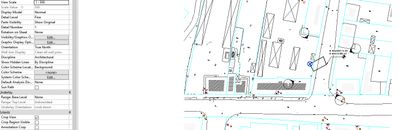

Funnily, when testing I seem to stumble on a bug. I left the project exactly as it is in the video, but when I opened it, this is how it looked. Looks like the building stayed in true north orientation but dwg link switched to project north. And I couldn't get it to align back as it should.
Bizarrely, I closed the Revit file, deleted the dwg completely from hard drive, reopened the Revit file, and it was shown there, in proper orientation!
This was just a test file, hopefully it won't happen in the real one 😕
Not sure what happened but when you link the DWG, it is important do it in a site plan that oriented to Project North.  Then you can move/rotate the DWG link to match your model and acquire coordinates.
