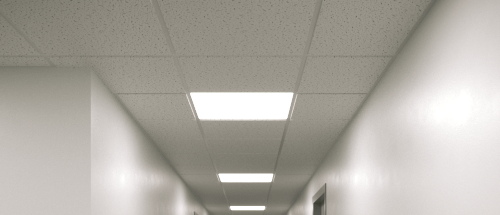

JJWGallagher
als Antwort auf: alex60
I don't understand why so many people actually model a suspended ceiling. It seems like a waste of time and energy. Just put a texture on it, you'd never notice the difference in a render and your working drawings shouldn't show that much detail either.
EDIT: Here's a ceiling from my render, it's a flat plane with good materials and displacement. Second Floor.png
Nachricht 17 von 21
als Antwort auf: JJWGallagher
Agreed that using material with bump map/displacement is the best option for typical lay-in ceilings. Modeling them is only necessary for geometric/sculpture ceilings.
