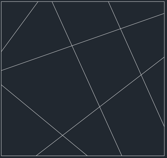

I am trying to create a mullion system with the following pattern;
However, Revit won't let me create angled curtain grids.
The only way I could think of achieving the same effect is by creating an in-place-model, however, I would prefer if I could use actual mullions.
Thank you for your help!

"Irregular Pattern"?  Isn't that an oxymoron?
If the irregular pattern repeat itself within the same squares then you can build it in a curtain panel family.
If it is truly random then you can use a line based family to draw the mullions on the curtain wall.
Or use divided surface from a mass face and use a list of named reference planed to create the division, then create an adaptive family and repeat it on the surface.
Huh? This, I'd love to see.
