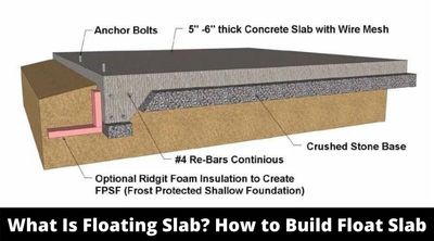

I'm having trouble figuring out the best way to create a floating slab pad for a garage I'm designing. I would like to be able to show a section through it with the concrete. I have a hunch all I can do is make the slab, then add a very short wall and taper it to get the form I desire (I'm avoiding this answer because I'd like to have it be one thing), or I'll have to make a custom family for it.
Which would be best, do you think? Is there another way to do this that I don't know about?

Is this what you are looking to do?
https://knowledge.autodesk.com/support/revit/learn-explore/caas/CloudHelp/cloudhelp/2018/ENU/Revit-M...

YES! I was looking all over for this! Thank you completely for this!

What I was referencing is this kind of slab foundation:
