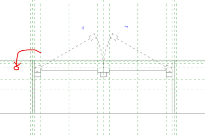

Hey all, I'm going nuts.  How do you report the wall thickness so that you can use it in a parameter equation?
I'm trying to place a window symbol element in the correct location with regard to the width of a wall, but I cannot get it to work.  I've tried dimensioning the wall thickness and setting that dimension as a regular instance parameter, and I also tried setting that dimension as a reporting parameter.  In both cases, if I reference the wall thickness in another equation I get this error when I adjust the wall thickness:
Parameter "SwingSmblOffset" cannot be changed because it is defined by formula "if(Thickness > 0' 4", 0.1875 * Thickness, 0' 0 3/4") - 0' 0 3/4""
SwingSmblOffset being the parameter that controls the symbol I'm constraining and
"if(Thickness > 0' 4", 0.1875 * Thickness, 0' 0 3/4") - 0' 0 3/4"" being the equation I used to define the above parameter.
It's baffling because the parameter works fine  until I change the wall thickness.  So Revit doesn't have a problem with the equation until the Thickness is redefined.
Any help would be great.  Here is a quick video showing better what I mean along with the .rfa file in question:

No, I'm not trying to pull the thickness to the tag.  I'm trying to align a symbol in the actual window family, but I need to use the thickness of the wall in an equation to constrain the symbol properly.  But when I try it errors out as show in the video.

You need to constrain the swing detail family to a ref plane, not to the window detail family.  See attached file.

@ToanDN Yes, that is what I was trying to do.  When I flex the family though, it gives me that error.   Though I did not think to load it into a project despite the error.    So, the error still occurs in the family you sent, BUT...  it doesn't matter I guess, because in the project it behaves as I want it to.  I got caught up trying to solve the error. Assuming it would cause a problem.  But it doesn't.  So.... I guess in this case... who cares about the error?

The warning occurs when you flex the wall thickness in the family, and the wall thickness is a reporting parameter driving a formula.  Cancel the flex or Undo to keep the formula intact.  It works fine in project.

That was a pretty painless fix actually.  I was expecting more of a challenge for my 2023 dry run.
All I did was Align and Lock the Detail Family to the Ref. Plane controlled by "SwingSmblOffset" Parameter and then Pad Lock the Parameter.   Flexes like a charm.
